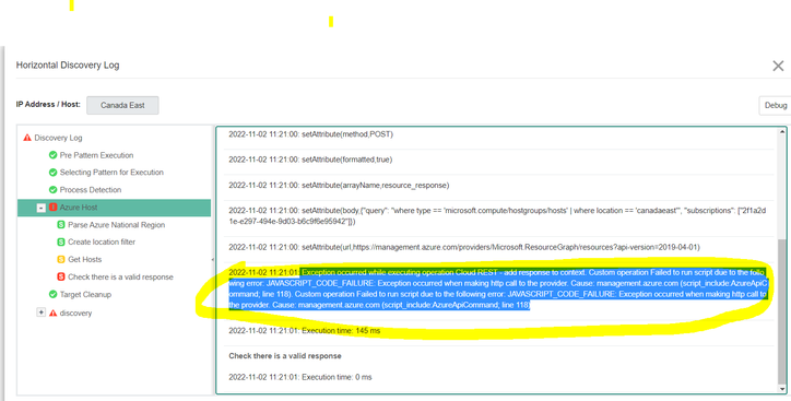

I am facing some error while runniing discovery below is the error kindly help to fix.
Exception occurred while executing operation Cloud REST - add response to context. Custom operation Failed to run script due to the following error: JAVASCRIPT_CODE_FAILURE: Exception occurred when making http call to the provider. Cause: management.azure.com (script_include:AzureApiCommand; line 118). Custom operation Failed to run script due to the following error: JAVASCRIPT_CODE_FAILURE: Exception occurred when making http call to the provider. Cause: management.azure.com (script_include:AzureApiCommand; line 118)

@Abhishek66 have you overcome this?
I'm receiving the same error.
Trie dplaying with Retry Configuraiton, throttling MID Server threads, finally increasing MID Server property mid.sa.cloud.request_timeout helps reducing various errors but doesn't bring 100% success.

Verify the Custom Operation is not modified or even exists in the table "Custom Operations", also verify the logs since this error may be a consequence of a previous one.
