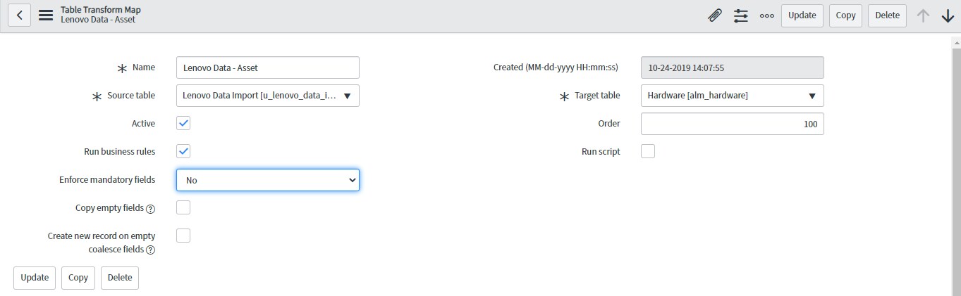

Hi
Can you check if data is populating in the 'alm_hardware' table via an import set? Also check if its corresponding transform map has the enforce mandatory field as 'No'.
More on enforce mandatory fields : Enforce Mandatory Fields | ServiceNow Developers
Let me know if this helps.
‎09-02-2022 04:57 AM
when the ""Enforce mandatory fields set to All Fields or only mapped fields"" still it is skipping the serial number Mandatory field.
what could be the possibility.
