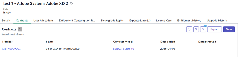

I have a requirement to add a count to a tab on Software Entitlement in the Software Asset Workspace.
"To keep consistency, a count should be added to the Contracts tab on Software Entitlements"
I believe that I need a (#) next to the Contracts tab (Contracts (#))...just like the "Expense Lines (#)" tab as seen in the image above.
I believe this is called a Record Badge Count, but am not certain.
I am in UI Builder, in the Software Asset Workspace scope, but can not figure out where to find the Tabs container. I think I just need to activate Record Badge Count for the Contracts tab, but I seem to have reached a blocker here.
Any help or point in the right direction would be appreciated...

Hello all,
Thank you, Naveen20 for such a detailed response....unfortunately, I can't get anything to work for the requirement I need.
As per my previous question, the "Contracts" tab is not a Related List, but a SAM Workspace Record Tab. There is no configuration toggle for "Show record count" or "Badge" property.
I have created a Data Resource (Aggregation Query 1), and have tried dragging the "Count" pill to the Page Collection (SAM workspace record tabs) both in the "Selected tab index" and "Selected tab" fields, respectively, and then binded the data to the field. This did NOT work.
I can not figure out how to get a badge count on the "Contracts" SAM Workspace Record tab.
I have tried the steps in the previous community response to no avail.
I feel like I am missing an easy step somewhere?
Are they're any other suggestions I can try?
Thank you all! It is very appreciated!

04-21-2026 11:35 AM
Hi Naveen20.
I can't get this to work. The Contracts tab is not a related list. It is a SAM Workspace Record tab, a Related List tab has a different configuration.
These are my current steps:
From here I have tried:
-Clicking on Settings, Edit content, and Sub-pages & Pages
-Creating Aggregation Query - I have created a Data Resource (Aggregation Query 1), and have tried dragging the "Count" pill to the Page Collection (SAM workspace record tabs) both in the "Selected tab index" and "Selected tab" fields, respectively, and then binded the data to the field.
Have you been able to add a badge count to a SAM Workspace Record tab in the past? If so, would you be able to show me an example? Perhaps I could reference that?
Thank you for your help, and I apologize if I not seeing or understanding something correctly?
