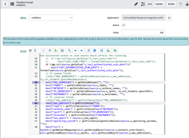

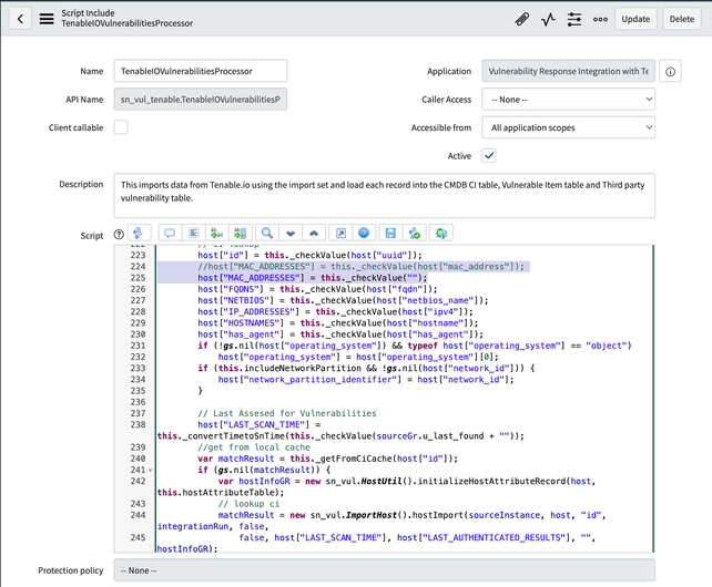

- Update the CMDB CI -> Lookup Rules : Deactivate the Mac-address CI Matching Rule.
- Clean up the Discover Item table entries with source is Tenable.SC
- Update Tenable.SC Asset Transform Target Table with Computer Table.
- Add empty the Mac-Address values for TenableSC Asset Import processor script and transform map onBefore script for not updating the mac-address from Tenable.SC.
- I'm not using Tenable ServiceGraph connector so it will not create any entry in Incomplete IP address table after the Discover Item table cleanup
Update TenableSCVulnerabilitiesProcessor
Update Tenable.sc Asset Transform-> onBefore script
