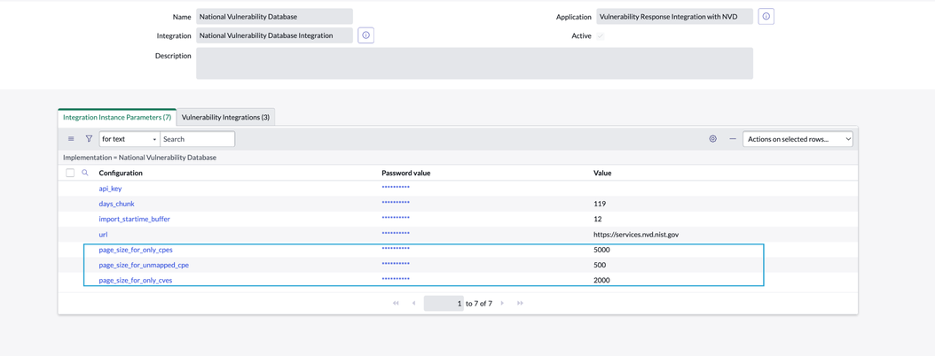

4) We have seen situations where the data from NIST NVD for CPEs - has grown recently and integration we have with VR may need some tuning, specifcally around the page size to handle this
- This helps reduce the file sizes down below 100MB for ServiceNow to process, in a 60 min window
- If file sizes are beyond 100MB the integration processing will error out
- If the files being processed take more than an hour, the integration processing will error out
- As of now, 150 seems to be the sweet spot for the Unmapped CPE page sizing (baseline it is 500)
-> 'page_size_for_unmapped_cpe'
