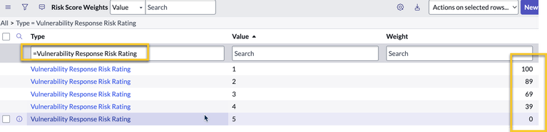

ok so it only shows you the top end of the weight on that table. I found that before but was looking for something that had a range in it like "20-30 = high".
I updated the table to show like the image below. With how I have it updated critical should start at 75 since Value 2 (High) stops at 74?
andy_ojha
In that example config, a 75 would actually come out to Value 1 (since it is greater than 74 - Value 2).
A 74, would come out to a Value 2.
Think of it as (Greater than or equal to)...
