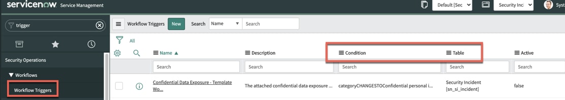

To see HOW a workflow can be triggered for SIR use the Workflow Triggers module:
To see WHAT workflows have been triggered (and are triggered) use the Workflow All Contexts module:
