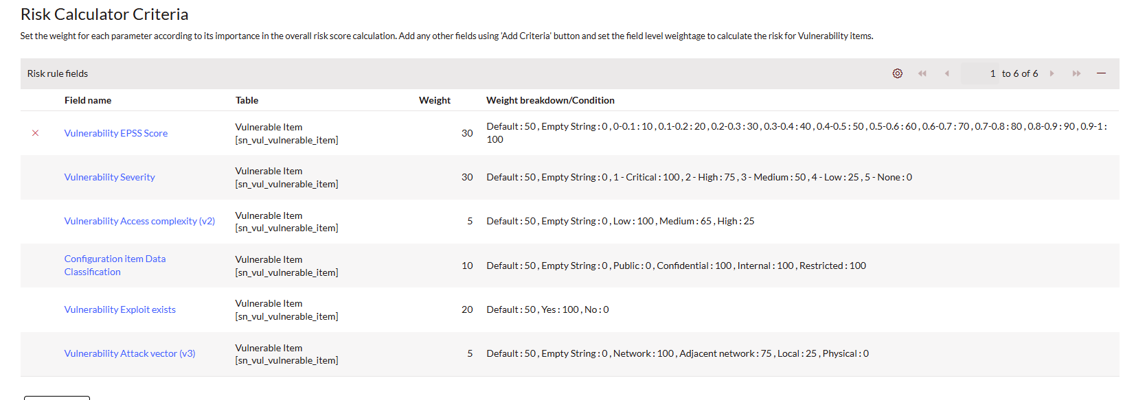

We have our risk calculator using Vul EPSS score, Vul severity, Vul access complexity v2, Vul exploit exists, Vul Attack Vector v3, CI data classification (custom field). So we want the risk score to be recalculated whenever one of these fields are updated.
I have updated the BR "Set recalculate flag" to look for changes in the fields we are targeting for our risk rule calculator but it does not appear to be changing the risk score unless I manually reapply the calculator or click the UI action to manually calculate the risk score.

Using the default risk rule calculator. This is using weights to calculate the overall risk score.
