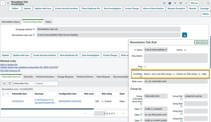

      • I used a VIT that was created and not part of a Remediation Task (i.e. did not meet the criteria of my Task Creation Rule which only handles High or Critical (Risk Rating)
        • Further, the VIT State was Open, and had a valid Assignment Group
      • Once the VIT.Risk Rating changed (None -> Critical), the Biz Rule was called, then the Script Include was called passing along the VIT and `multiUpdate` value of True into the function 'groupItemByVulnGroupRule'

On your Remediation Task Rule > Condition, do you have anything else in the Condition that could be causing a wrinkle?

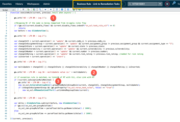

  • On the Biz Rule (Link to Remediation Task), I added some log statements to:
    • 1) Verify the Biz rule was actually getting triggered
    • 2) Log the value of 'multiUpdate' to ensure it was getting set to True
    • 3) Ensure I was hitting inside if the IF statement (where the Function groupItemByVulnGroupRule) gets called

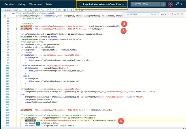

  • On the Script Include (VulnerableGroupRule), I added some log statements to:
    • 4) Verify within the Function 'groupItemByVulnGroupRule', the function was getting called for the VIT I was testing with
    • 5) Log the value of the 'multiUpdate' to ensure the value of True was being passed to the Function from the Biz Rule
    • 6) Ensure I was hitting the condition of the IF statement (right under the script comment "//re-grouping in case of any update or in case no parameters are passed.")
It's a bit overkill, but tracing our steps through 1 - 6 above, ideally should shed some light on where we are being blocked for the use-case you have.

You are correct, we have modified the TPVE normalization business rule and script includes to account for the source risk score (Active Risk in our case). The severity of the TPVE records updates when the Active Risk score changes, which does send VITs through the risk calculators again, and the Risk Rating of the VITs is updated as expected. However, the Remediation Task rules are not re-evaluated as we would expect, so the VITs do not end up in tasks even though they match task rule conditions.

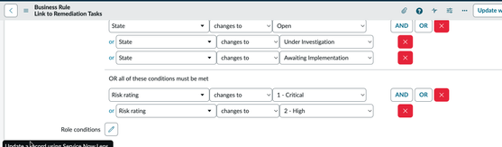

I previously found and modified the conditions of the BR you mention - Link to Remediation Task - so that if the Risk rating value "changes to" either "1-Critical" or "2 - High", the rule should be run. I also modified the BR script to include the risk rating as one of the 'multiUpdate' possibilities, in case that mattered. See below for current version of script:
    //Skipping Br if the same is being reapplied from re-apply rules flow
    if (!gs.nil(current.disable_flows) && current.disable_flows.indexOf("sn_vul.task_rule_vit") >= 0)
      return;
    var before = new GlideDateTime();
    var changeInCI = current.operation() == 'update' && current.cmdb_ci != previous.cmdb_ci;
    var changeInAssignmentGroup = current.operation() == 'update' && current.assignment_group != previous.assignment_group && current.assignment_type == "1";
    var changeInState = current.operation() == 'update' && current.state != previous.state;
    var changeInVulnerability = current.operation() == 'update' && current.vulnerability != previous.vulnerability;
    var changeInNumber = current.operation() == 'update' && current.number != previous.number;
    var changeInRating = current.operation() == 'update' && current.risk_rating != previous.risk_rating; //added for risk rating
    var isInserted = current.operation() == 'insert';
    var multiUpdate = changeInCI || changeInState || changeInVulnerability || changeInNumber || changeInRating || isInserted;  //updated for risk rating
    // if exception rule is matched, no linking of RT with Vit, else Link with RT
    if (!current.isExceptionRuleMatched) {
        new sn_vul.VulnerableGroupRule().groupItemByVulnGroupRule(current, changeInCI, changeInAssignmentGroup, multiUpdate);
        if (changeInAssignmentGroup && (gs.getProperty("sn_vul.rerun_task_rules", false) == "true"))
            new sn_vul.VRRemediationEffort().unlinkAndRegroupItems(current);
    var delta = GlideDateTime.subtract(before, new GlideDateTime());
    if (gs.nil(sn_vul_cmn.groupRuleTime))
        sn_vul_cmn.groupRuleTime = parseFloat(delta.getNumericValue() / 1000);
    else
        sn_vul_cmn.groupRuleTime += parseFloat(delta.getNumericValue() / 1000);
})(current, previous);
