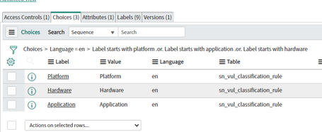

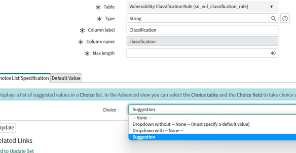

Yes you can add additional classifications to the set values on the classification rule. The classification field is a string type field with the 'Choice' set as Suggestion (Hence you see the suggestion Icon on the classification rule form).

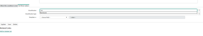

The field has choice options similar to any other choice field in the system. OOTB It has only two choices which you mentioned (Platform and Application) but you can create more choice. For example we have added "Hardware" and other choices.
which appears on the form as a suggestion
