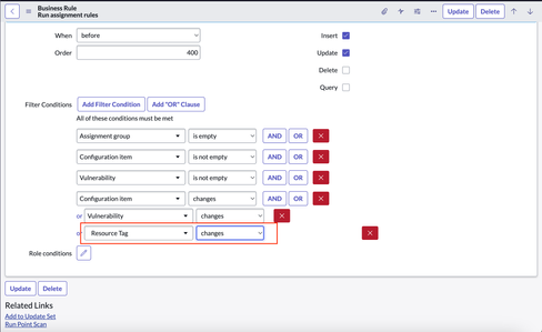

Hi Joe,
Thank you for the information. The CI remains the same and wants to trigger the assignment rules only on change of resource tags on discovered item.
Can we add the condition discovered item.resource tag changes on the BR 'Run assignment rules' similar to the screenshot attached:
JoeH91068231407
Hey Sath,
No, you do not want to add that condition.
  1. It would run only when Vulnerable Items are updated and not when Discovered Items have been updated.
  2. If it ran, it would slow down integrations that insert/update Vulnerable Items. That process is already resource intensive.
Instead, you want a new Business Rule or Flow that is linked to Discovered Items being Updated. Also, you want it to be configured to run independently so that it does not force a process to wait while assignment rules run for associated VI's. This would mean either an ASYNC Business Rule, a Flow (usingFlow Designer), or an Event & Script Action.
I hope that this helps,
--Joe
