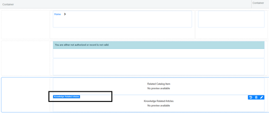

I would first check the Service Portal page and widget setup, because adding articles to the Related Articles list on the Catalog Item does not always mean they are automatically rendered by the main catalog item widget.
Make sure the Knowledge Related Articles widget is actually present on the sc_cat_item page. Then open the widget instance options and check whether the maximum number of articles is set to a value higher than 0.
It is also worth checking whether the page has been customized. If you are using a cloned catalog item page, review it in the designer tool and confirm it's present.

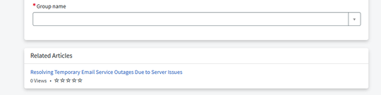

Hello @KaveeshaF ,
So as you have ensure all the checks..
adding also ensure that if you are having custom page or SC Cat Item ootb page so it should include the Knowlege Related Articles widget :
In my case I checked working properly :
