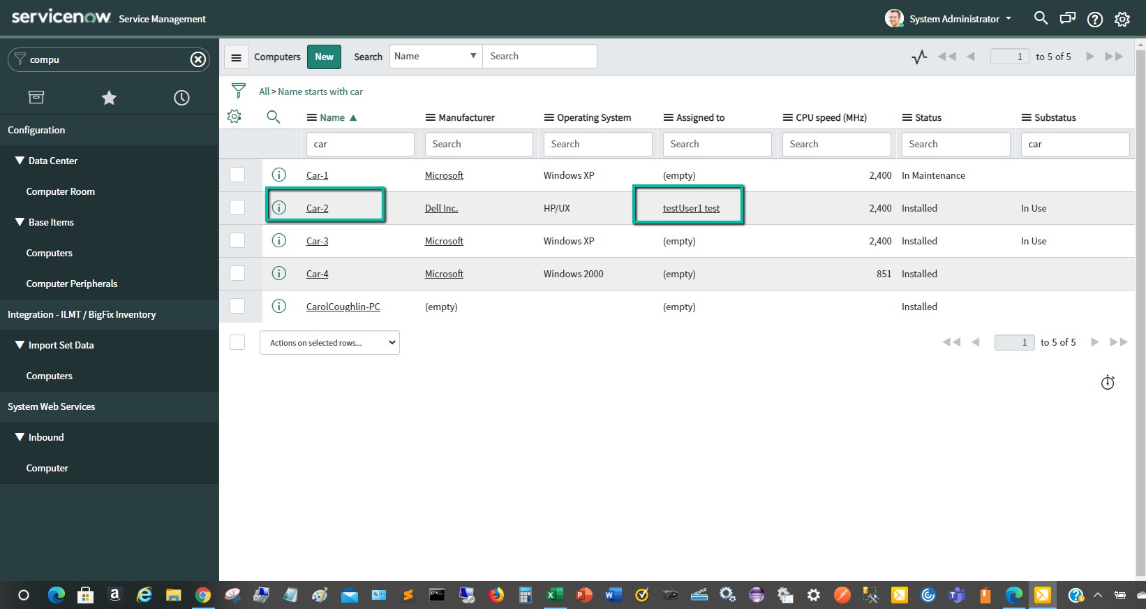

I am seeing that there is record for In Maintenance sync is in both direction in Asset CI State mapping table.(snap below)
As per this all 4 scenario should work, but only 1, and 2 are working and 3, 4 are not.

A change to the Status field on a hardware CI does not push its value to the Asset's State field... for Hardware CIs (or any child of cmdb_ci_hardware), the 'Hardware Status' field on the CI should be used. It's very confusing, but it's how it works. Use the table at "Asset > Administration > Asset-CI Hardware Status Mapping" to determine the right sync values (alm_hardware_state_mapping).
You will want to adjust your CI list views to show the correct fields.
