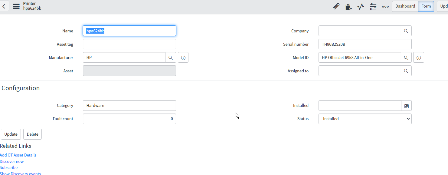

Hello Team,
I am discovering some printer but for some reason asset record is not created even though I have Manf and Model information discovered. Is there any property which needs to be set?
Any help greatly appreciated.

Thanks Sulabh.
Casper6060
For anyone else having this "issue", there is a property called glide.create_alm_asset.async which by default is set to true, when set to true the creation of an asset is bound to a scheduled job called Asset - Create asset delayed sync which runs every 15 mins. This is to reduce load on the server, so if you wait up to 15 mins it should work.
If you want you can set the value in the property to false and this will create the Asset immediately.
