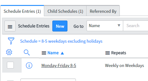

step 1. Create a schedule - Navigate to System Schedules > Schedules (usually there is a default schedule that is used throughout the system ; 8-5 weekdays excluding holidays)
Inside this you may schedule the working hours and holidays as seen below:
The child schedule will provide you with holidays and primary tab schedule entries with no. of working hours in a day and weekly 5 days.
