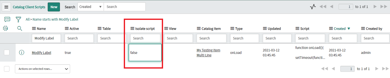

Here you go to make it work for both native + portal
onLoad Catalog Client Script on Your Catalog Item
UI Type - ALL
Isolate Script - False
a) This field is not on form but from list you can make it false
Script:
UI Type - ALL
Script:
