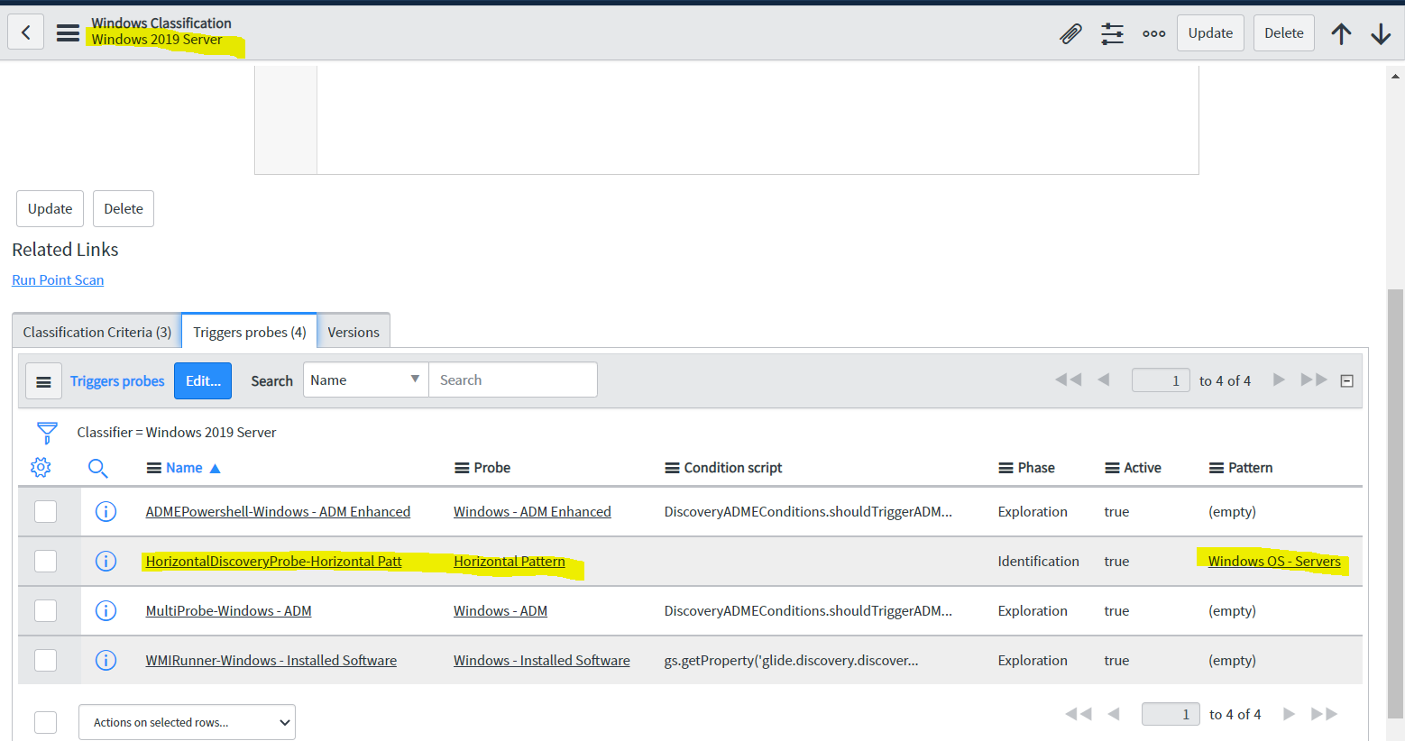

When I ran the discovery to discover the MID server using same MID server, I am getting below error message in discovery log. I believe we can discover the MID server using same MID without any credentials.(correct me if I am wrong). The OS on the server which I am discovering is Windows Server 2019 Standard
 "Sensor error when processing Horizontal Pattern: No sensors defined"
Please advise if I am missing any sensor. I am seeing that there is no sensor defined in Horizontal discovery.(last snap)

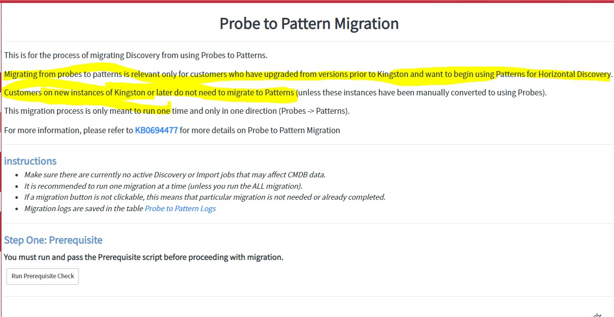

Thanks Anshu,
But I believe this migration is not needed if we are on Kingston or newer version. We are on Rome.

Hi Anshu,
Yeah pattern is launched but it errors out as I shown above in my snap shot. In Discovery log it says no sensor defined.
Here it is again.
