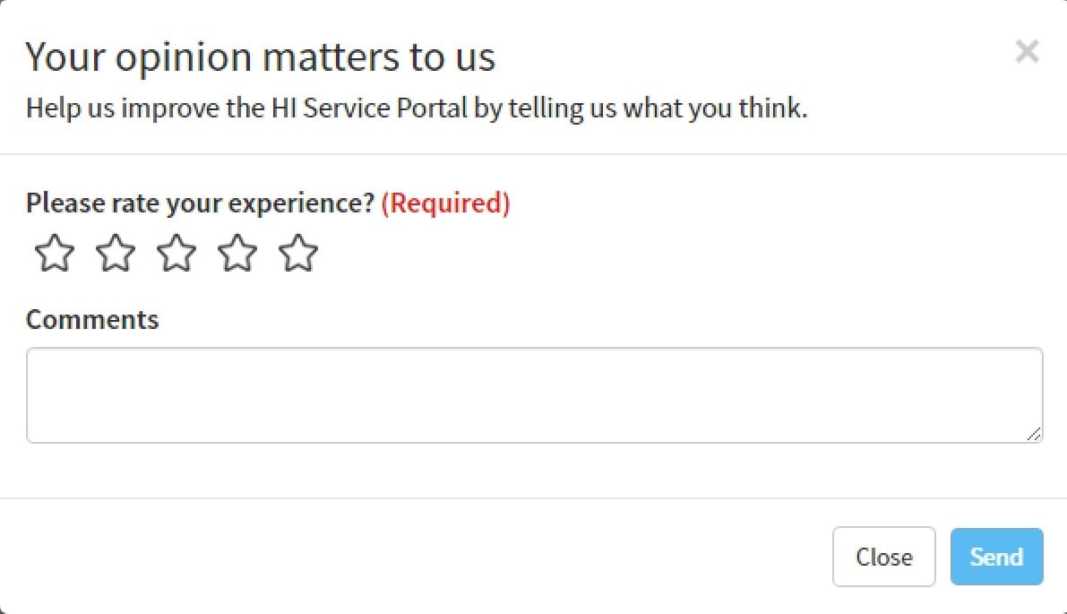

We'd like to establish a simple Service Portal feedback survey exactly like the ServiceNow HI portal.
We require assistance establishing the following:
1. Does anyone know how to create the survey (see above) via a widget that "pops up" when a "Feedback" button is clicked?
2. Where does the data get populated into?
Some help on this would be really appreciated. I'm pretty confident there will be a lot of other people that would get value from this as well. So would be good to have a thread with clear and concise responses.

This widget which you see above is a custom implementation and does not use the underline survey schema.
We created a new table which uses the Document ID and Document class to link a feedback with the Page, so in this case document name will be sp_page and ID being the sys_id of the page. You can extend this to any other class type as well with this design.
For the UI you can use $uibModal (Angular directives for Bootstrap) in the controller and create a ng-template [sp_ng_template] which can be instantiated using events.
