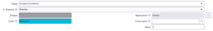

07-03-2023 05:22 AM
Hi @AdamUMC ,
Based on your requirement, I would recommend you to go to sys_report_chart_color_list a define the color for the specific value - e.g.:
Value off course refer to the value of the priority.
Best regards
Anders
07-03-2023 05:37 AM - edited 07-03-2023 05:41 AM
Hello Anders,
Thank you! But as I understand, defining a color for a specific value ("field "Element" from your screenshot), sets that color for everyone using that (specific) value.
Imagine someone wants to use default colors or other colors, is that possible next to this solution?
