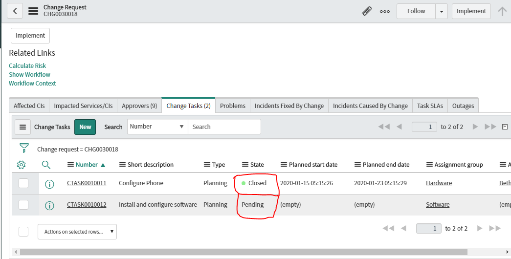

Hi Dirk,
I tried the same way, automatically tasks are adding when we create the CR. But when we close the first task, second task is not open automatically and its still on pending only. Please find the attached screenshot.
I have given task order 1 and 2. Also i tried 100 and 200.
Please let me know if you have any fix for this.
Antony
