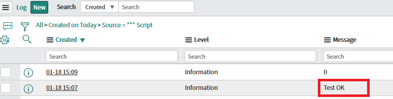

Execution result in "System Logs" > "System Log" > "All"

Note that the output of the gs.info() is written to "System Log" > "Script Log Statement". The script is just outputting string "Test OK" to the log as can be seen below.
