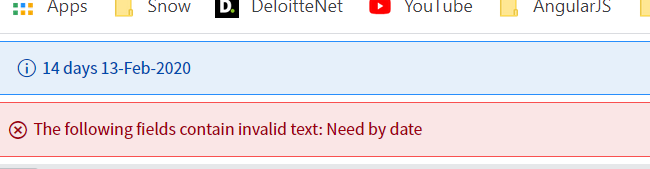

Hi Harsha,
As per the above code date variable is setting with proper format but when I try to submit the request it is showing below errro
