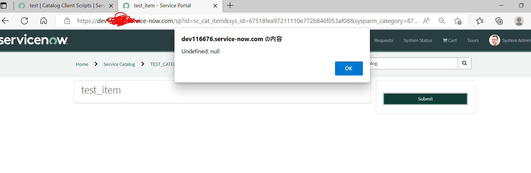

Thank you for your kind explanation!
This is the test result using [getXMLWait()].
You are not handling return values properly.
This is a test of "getXMLAnswer(callback)".
I modified the script slightly to display the return value. "alert (test_response);"

This didn't work either. .
