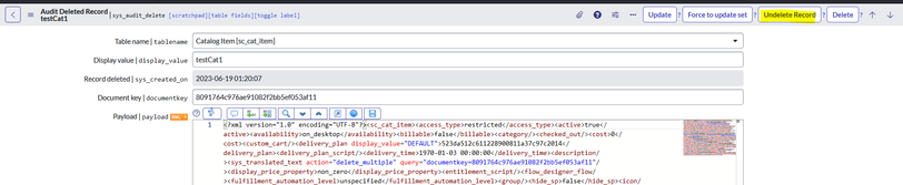

Navigate to deleted records from the left navigator
You'll see two records related to the catalog item which you deleted
Open both the records and click on the UI action "Undelete record"
