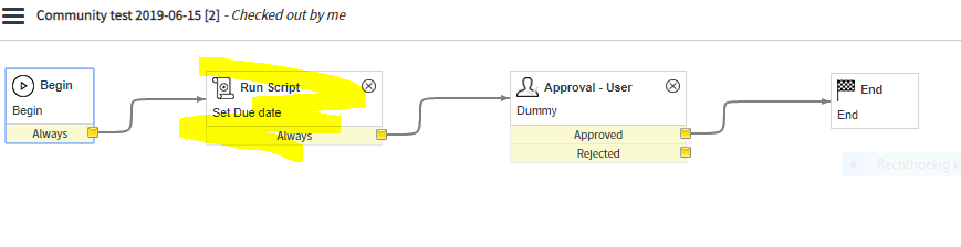

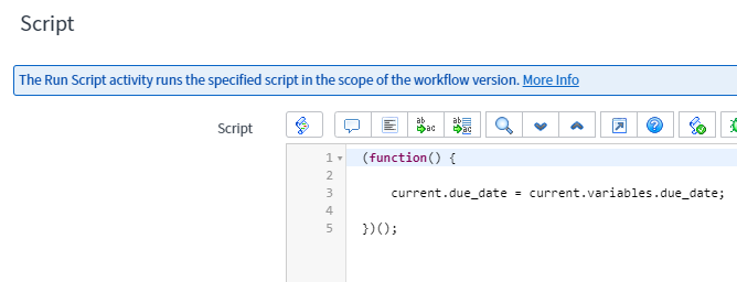

Hi there,
You could add a Run Script step to your workflow, which fills the due_date based on the input on your variable.
See (working) example below. In my example I named the variable "due_date".
Kind regards,
Mark

Hi there,
Kind regards,
Mark
Kind regards,
Mark Roethof
10x ServiceNow MVP
