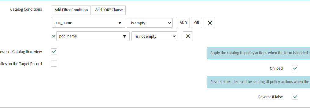

On this catalog item I have a field that is greyed out and if the field is empty, a notification pops up at the top of the screen using a Catalog UI policy. However, I would also like to stop the form from being submitted if this field is not populated. I have tried g_for.setMandatory() but this doesnt seem to work:
When to Run:
Catalog UI Action:
Catalog UI Policy Script
03-23-2022 06:37 AM
Hi Andre,
Can you make this field mandatory from the catalog UI policy action instead of using g_form.setMandatory. You are making this field read only from UI policy, same way you can make it mandatory as well.
