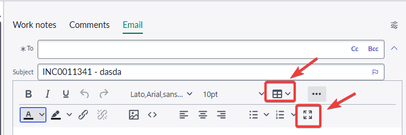

By modifying the glide.ui.html.editor.toolbar property, we can reorder the toolbar header options of HTML fields. How can we do the same (reorder toolbar buttons) for the Email client in the Compose section?
It looks like the relevant setting would be glide.ui.email.composer.toolbar, but it belongs to the @Servicenow/now-email-client application, which is read‑only.
Specifically, I’d like to swap the Table button (rarely used) with Fullscreen (currently the last option).

Thank you @Tanushree Maiti.
Unfortunately, the KB you referenced doesn’t apply in this case. It refers to the HTML editor toolbar used for article editing. However, I still tested the steps described there and confirmed they do not work for the email client toolbar.
Note: In step 6 of KB “Customizing "Compose Email" in the Email Client - Support and Troubleshooting”, it states that the email client toolbar options should be configurable by modifying the glide.ui.html.editor.v4.toolbar.line1 global property, but this doesn’t work either 😞
