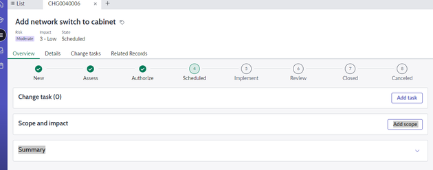

anyone have any document / reference how we can add a process flow in service operation workspace on change management.

OOB it's already there (see screenshot). Did you remove it previously?
Mark
I think you can go to the legacy view and adjust the form view for the 'SOW-Change-Overview' view. Add 'Process Flow' on top and you should be ready to go.

I see the problem. The Processflow is only available in the overview. not in Details (i did also wanted to disable the overview and only use the Details tab.
Mark
due to some reasons we have removed it. I want to add it back any idea how we can add.
