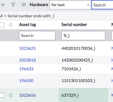

I need to write a background script to remove _) from end of serial number in alm_hardware. Any assistance is appreciated.

Hi @purdue ,
You can try below background scripts:
Script 1:
var al = new GlideRecord("alm_hardware");
al.addEncodedQuery("serial_numberENDSWITH_)");
al.query();
while(al.next()){
gs.print("Before Update:"+al.getValue("serial_number"));
var str = al.getValue("serial_number").toString();
var str1 = str.split('_');
gs.print("After Update:"+str1[0]);
al.setValue('serial_number',str1[0]);
al.setWorkflow(false);
al.autoSysFields(false);
al.update();
