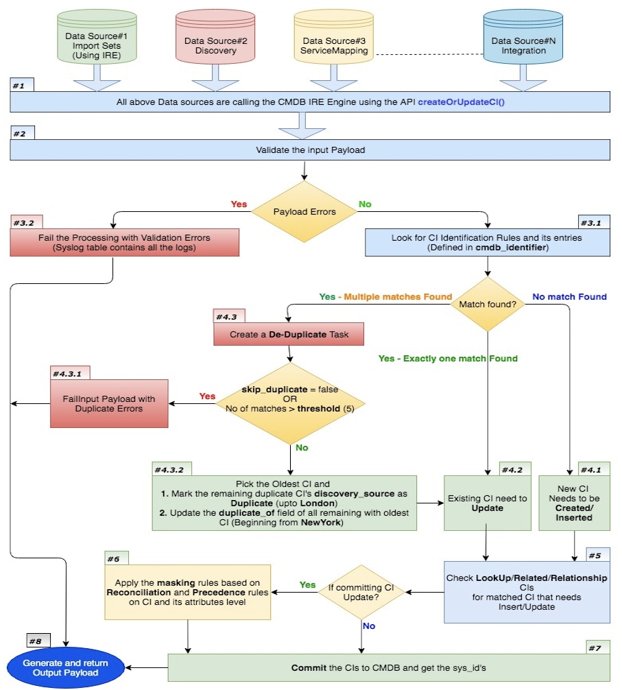

I have some ~20 CIs in the cmdb_ci_pc_hardware class, that are marked as duplicate and have a reference to master CI, using the duplicate_of field that's pointing to the correct master.
However, the Duplicate task to handle these CIs seems to be missing and I'm not sure how I can recreate it.
glide.identification_engine.skip_duplicates = true
glide.identification_engine.skip_duplicates.threshold = 5
Default settings for both, but the Scheduled CMDB Health Jobs does not create a new Duplicate Task, and I can't find an old one where the name of a duplicate CI is referenced.

Also, what happens to the ~20 CIs that I have since threshold value is 5? Is it correct that I need to edit the threshold to ~30 in order to get a Duplicate task for these...?
