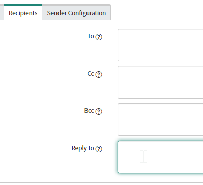

Allen Andreas
Within the "Recipients" tab there's the "Reply to" field:
If it's not there, you may need to add it to the form.
Allen Andreas
Thank you very much! It was so easy.... lost a lot of time on this
