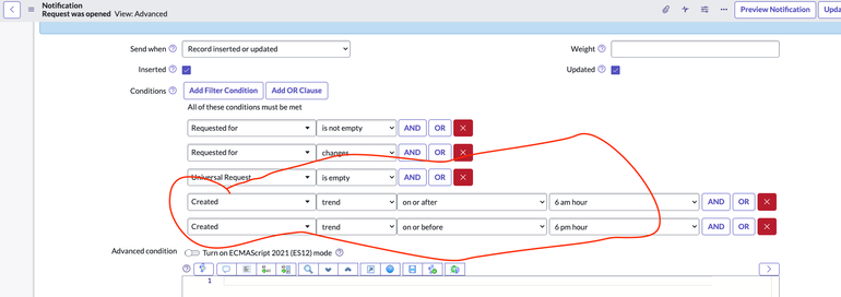

Hello community i need te create a notification that get triggered only between 9h and 18h when incident record is created is there any solution for this?
Thanks!

not possible directly with notification create/update checkbox
You can use after update business rule and use gs.eventQueueScheduled() and trigger it the next day at 9am.
In that business rule check if the current date/time (france) is between that 9am to 6pm, if yes then use gs.eventQueue(), if not then in eventQueueScheduled() you can inform system when this event should be processed.
so in your business rule determine the next working day and set the start time as 9am and then use that
eventQueueScheduled(String name, Object instance, String parm1, String parm2, Object expiration)
Get next business day (date/time - based on schedule)
I believe I have answered your question and you can enhance it further from here.
