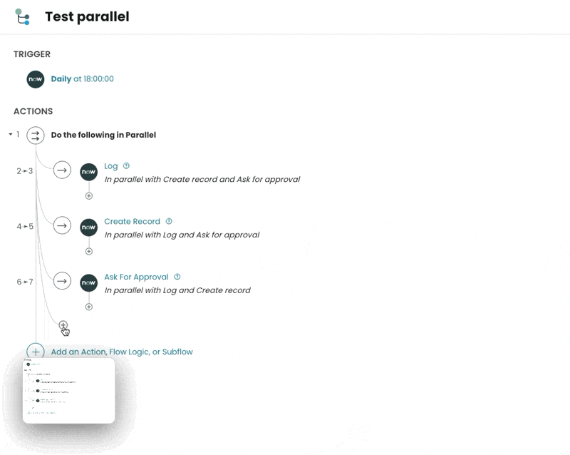

In your example, you have three tasks running sequentially on a single branch.
To execute three parallel tasks, you need to create more parallel branches.
Click on the larger (+) to add a parallel branch. Once you add another parallel branch, you can drag one of your actions to the new parallel branch.

Correct, the point of 'Do the following in parallel' is to run actions in parallel.
To achieve your desired outcome, try updating your flow to have 3 parallel paths, with a 'Create task' in each parallel path (check out the screenshot).
