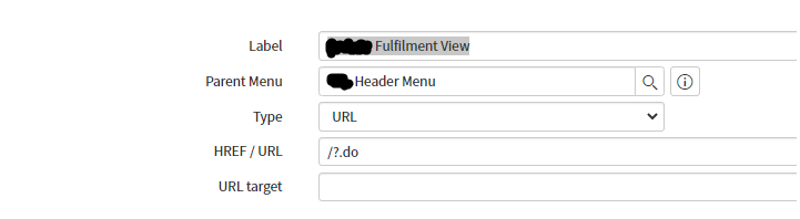

Step 2: Create a menu under self service for Service Portal
Step 3: Create a menu in Service Portal to take user to fulfiller view.
Portals > Choose your Service Portal > Header Menu > Create a Menu Item and set an order based on your need.
While creating menu item please note below recommendation:
The key here is to redirect user to /?.do (Do not redirect users to navpage.do or nav_to.do - The OOB script include (SPEntryPage) checks if user is in navpage or nav_to and pushes them back to Service Portal. So as highlighted redirect users to /?.do
