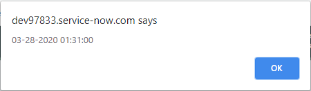

Here is the due date on the record
Here is the value it's returning to validate yes, it's sending that due date to the script
here is what is returning from the server when it adds 1 day
It's populating that exact date/time in the variable
That's true, if i were in GMT. I'm in MST and that's what my profile is set to, as per the due_date
Thoughts?
