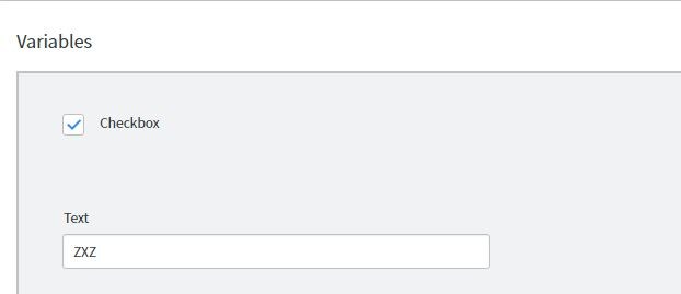

tanumoy
do you have variable editor in the Requested Item form?
If yes, please give a screenshot of that portion.
Sorry i dont understand, the variables are what make the order guide, the RITM form is just a normal form which i have added the u_leaver_date field to?
Variable Editor shows the end user input (what user has given while raising the order guide) in the Requested Item form.Capture.JPG
