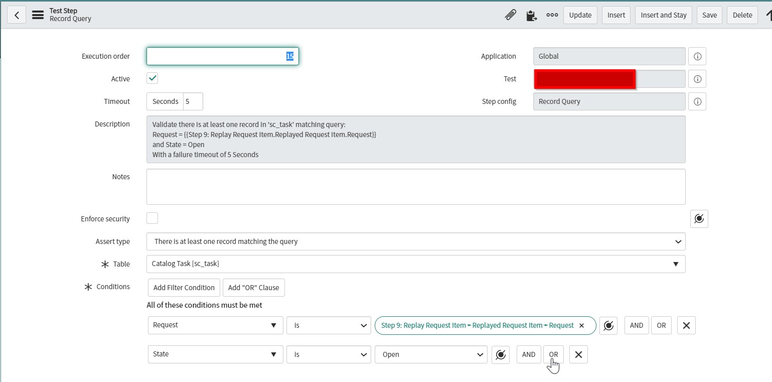

I have an ATF that I created. It involves ordering an item from the Service Portal. When I get to the approval process and marking tickets as Closed Complete, I jump to the server section and use the Replay Request Item. This allows me to grab the ticket number.

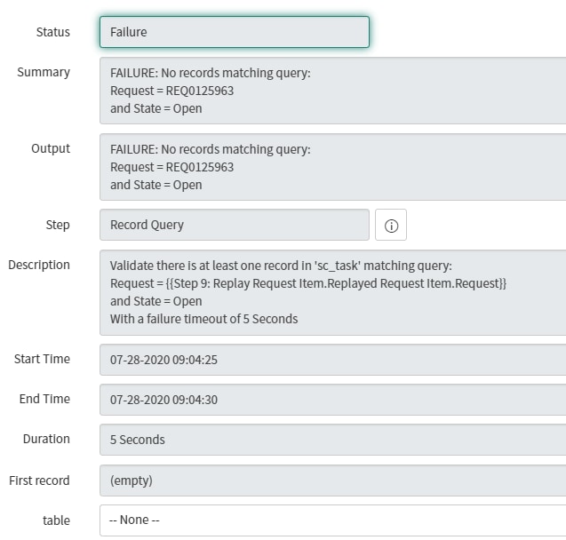

Where my test is failing:
It fails at Step 15. I am trying to do a Record Query to get back the sc_task and close the task, but the error I keep getting is "No records matching query" as shown below:
This is what my query step looks like:
Once this step is figured out, I want to add a Record Update to close the sc_task.
