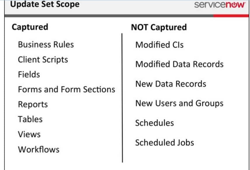

I'm a new customer and just getting started with update sets.   I've been able to successfully bring over may items from one environment to the next.   However, there are many items that don't seem to transfer, which is causing some problems and more than a little frustration.   For example, values entered in System Security>Groups did not transfer.   Maintenance Schedule Entries have not transferred either.
Is there an easy method for determining whether something is eligible for inclusion in an update set?

Schedule jobs, data modification will not be captured in update set . Instead you can add it through force to update set Ui action for schedule jobs.
https://community.servicenow.com/external-link.jspa?url=http%3A//www.servicenowguru.com/system-defin...
Try XML for those which cannot be captured in update set.
http://wiki.servicenow.com/index.php?title=System_Update_Sets#gsc.tab=0
Nia McCash
You can also view all the items being captured as update set entries by going to https://[instance].service-now.com/sys_update_xml_list.do?sysparm_query=
If you're unsure if something has been captured as part of an update set, sort the list by updated date, make your change, refresh the list to see if your change registers as an update set entry.

Update sets track customizations under these conditions:
1. Where the table has an update_synch dictionary attribute.
2. Where there is a special handler to track changes to multiple tables.
3. Where the administrator has not specifically excluded a field from updates.
In general, update sets capture configuration information but not task or process data. For example, update sets track service catalog item definitions and related configuration data like variables and variable choices. However, if you test the service catalog by placing orders, the order requests, items, and catalog tasks are not tracked by update sets.
Update sets have a limited capacity to transfer data as application files. This is intended to provide demo data for applications. For larger data transfers export data and import it with an import set or import set web service.
To see a list of tables on which customizations are tracked, navigate to System Definition > Dictionary and filter on attributes CONTAINS update_synch.
