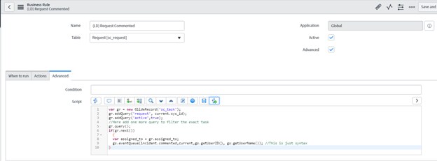

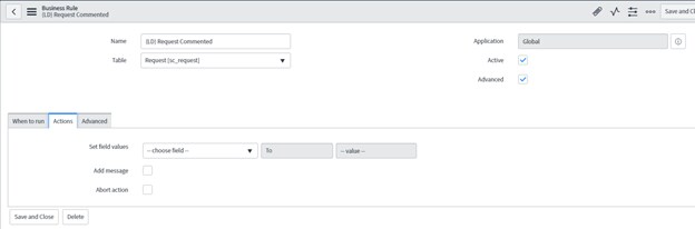

Thanks so much for your help! I have tried as you said but the message does not send. I have added as a test, my own email address to the Notification 'Who will Recieve" and the Notification is triggered under the correct circumstances, it just wont send to the Task Assigned To:.
Below is how I have it setup:
Notification
Event
Business Rule
Any idea's?
