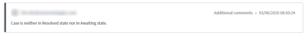

Hi Madhav,
I changed the code on the Inbound action to the code you gave me. I then sent another forward email with the same watermark and ref number in the subject line.
As before instead of updating the original case, it created a NEW case with the following
in the comments. I hope this helps your understanding of what is going on.
