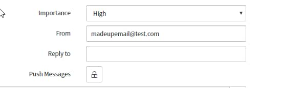

One issue I know for certain that was impacting my company back in November or so with Verizon was if the notification that was being sent out....had a "custom" From address.
Meaning here:
If you are trying to send a notification via SMS with that field filled in and the users have Verizon carrier...it won't go through. I believe Verizon has some sort of filter set up on their end to where if this notification comes across to their side and they see the "From" being masked like mentioned above...then it treats it as spam and it won't send.
Sprint and others seem to have no issue as the same notifications were reaching their phones, but not Verizon.
Finally after a bunch of troubleshooting, I removed the custom From email address and left it blank and voila...they got it.
I would compare your notifications and see if the ones that seem to be "spotty" have a custom From address and if so...simply remove it.
