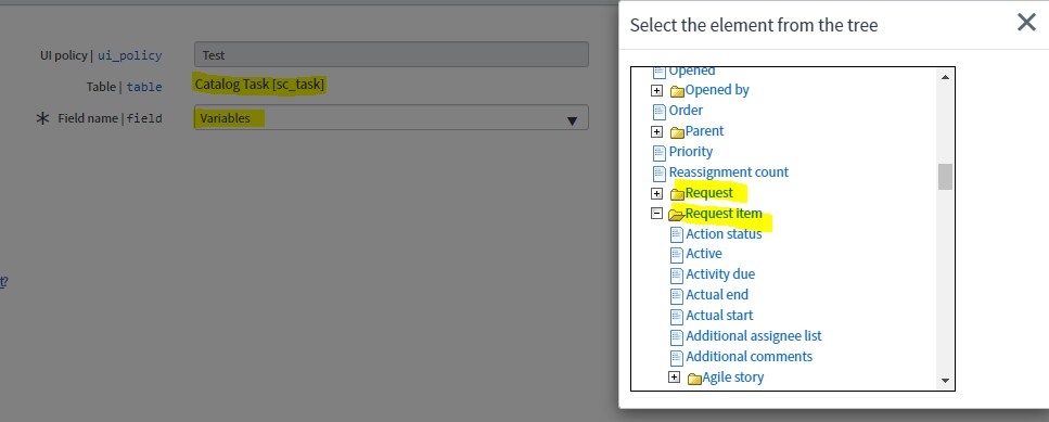

_raj_esh
Hi Anshika,
I think the dog walking in UI Policy will work. Try the below.
Create a UI policy and under the "Catalog UI policy action"
Select the fields from the Elements.
Hope it helps.
Raj
