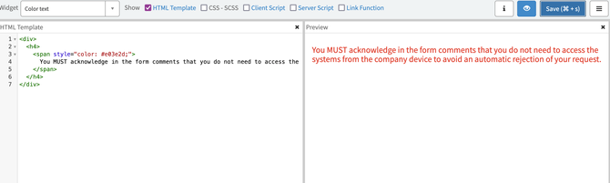

ChrisBurks
@bekfrohonestly. That's how it's done.
Could there be some CSS styling in the Theme that has an !important overriding span tags nested in h4 tags?
