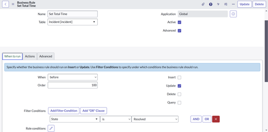

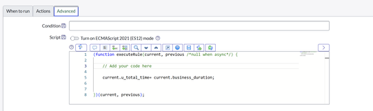

‎12-26-2024 06:09 AM
Hi @Burhan2 ,
Follow below Business rule:
Then in advanced write below code.
You can remove the condition if you want to always populate the field.
Please mark my answer as helpful/correct if it resolves your query.
