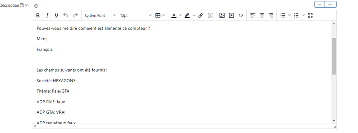

I have a description like this for all my records :
But i want to remove from the description who is an HTML type variable all the part who start with 'Les champs suivants'.
How I can do that ?
