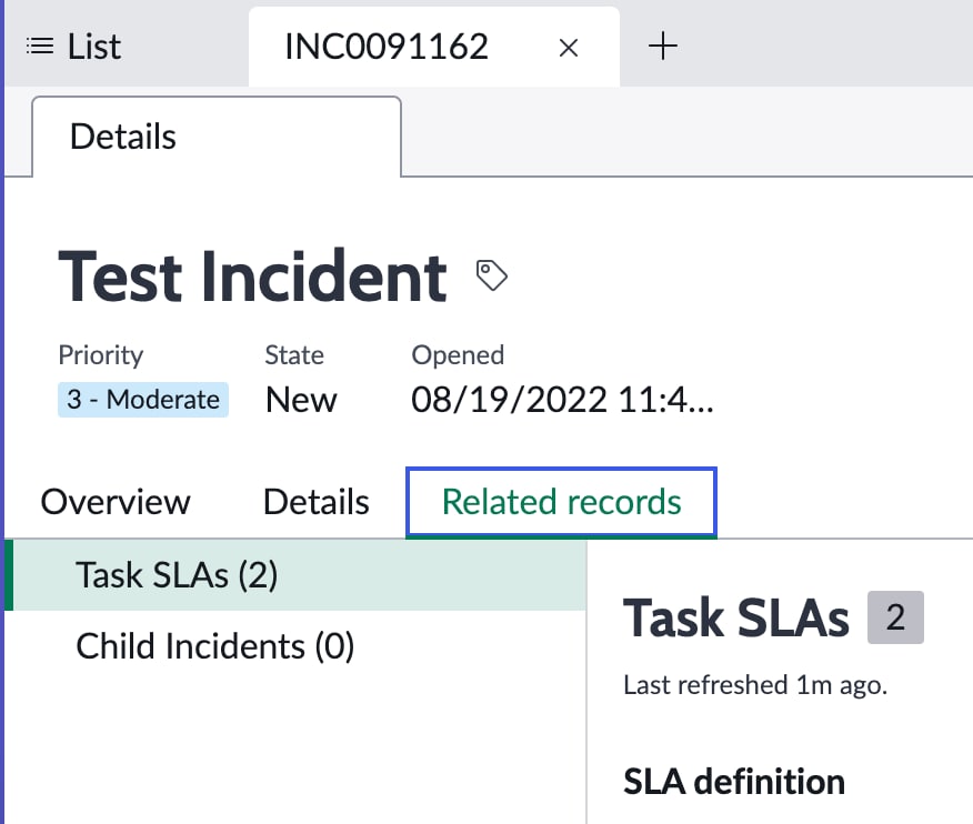

Hi Sandeep,
Thanks for the reply.  That removed "Affected CIs" from the "Related records" tab:
But it did not remove the CI information from the "Overview" tab in my original screenshot:
Any other ideas?
Chad
I don't have any other approach.
