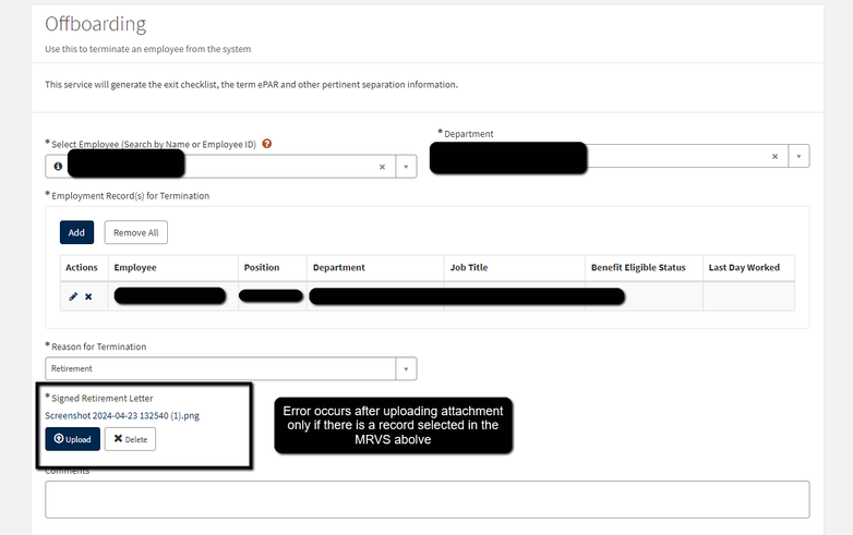

Hi all, I am having an issue with a popup on the portal when adding an attachment to an attachment type variable, specifically after adding a record to an MRVS. It doesn't seem to pop up the error if there is no record in the MRVS which makes this even more odd.
The message states: "Unable to identify source of the Read operation on table 'sn_hr_core_job' from scope 'Service Catalog REST API'. No Restricted Caller Access privilege records were created. The operation was allowed because target resource RCA policy is set to 'Tracking', but will be blocked with the 'Restricted' policy. Please contact the application admin."
Steps to reproduce:
1. Navigate to the record producer in the catalog on the ESC portal (no widget customizations)
2. Add a record that references the sn_hr_core_job table
3. Add any attachment an "Attachment" type variable
I have added a handful of different Restricted Caller Access records, but can't seem to find the right combination. Has anyone come across this issue? Any suggestions on how to fix this?

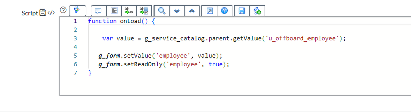

1. I am using the g_service_catalog.parent.getValue() api on the MRVS to populate the "Employee" field. Because the message references the "'Service Catalog REST API'" I thought it may have to do with that.

Thanks for the info!
This appears to be an issue with the new "Auto-populate" feature on variables. As soon as I turned all of that off and went back to a GlideAjax (I'd also imagine g_form.getReference() with a call back would work) the issue was resolved. This seems to be a brand new functionality, probably just needs some bugs ironed out.
Thanks!
