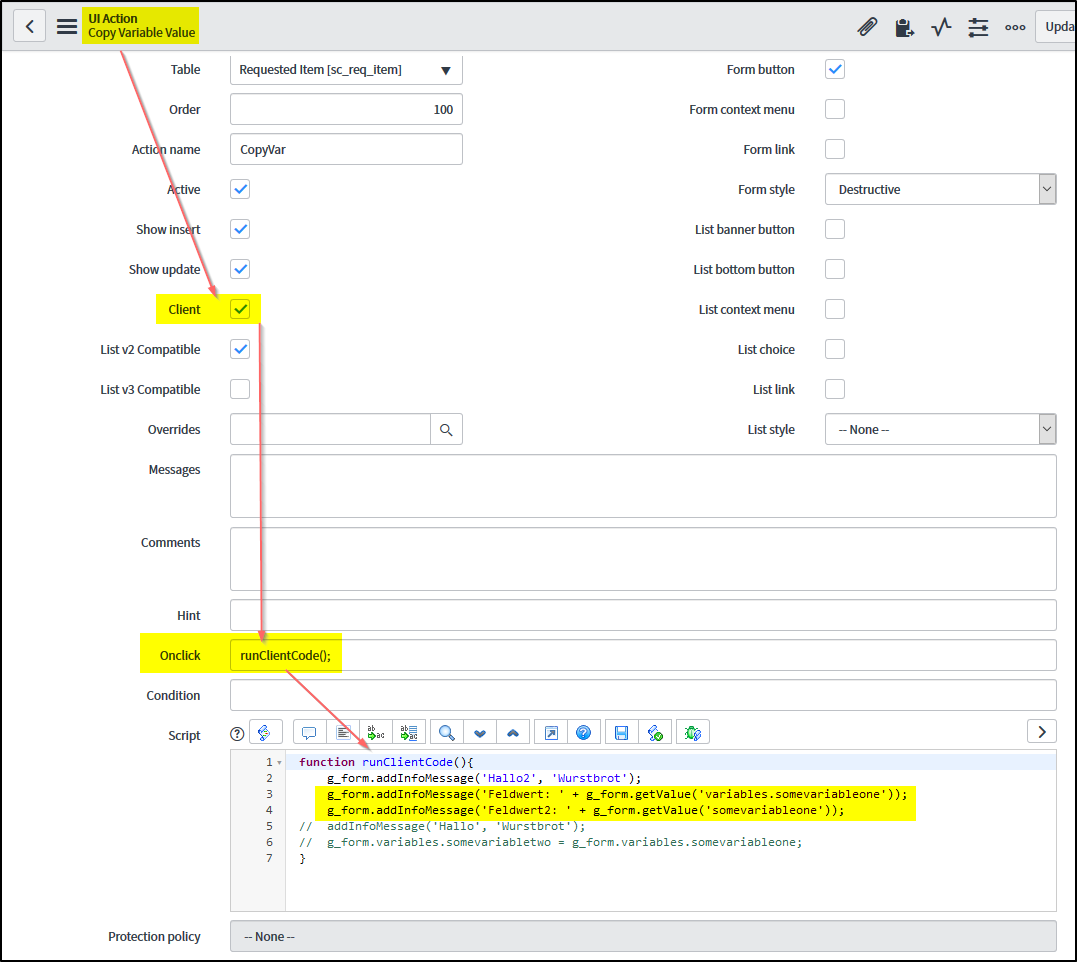

Then, I created a UI Action (Button) to sit on top of the form see screenshot below:
Make sure to mark that UI Action as "Client" = "true" like shown above, and make the "Onclick" value point to the function defined in your UI Action!
Look at the syntax of how you can access the variables of your Requested Item
Clicking that Button just showed the three Messages at the top (see screenshot below):
