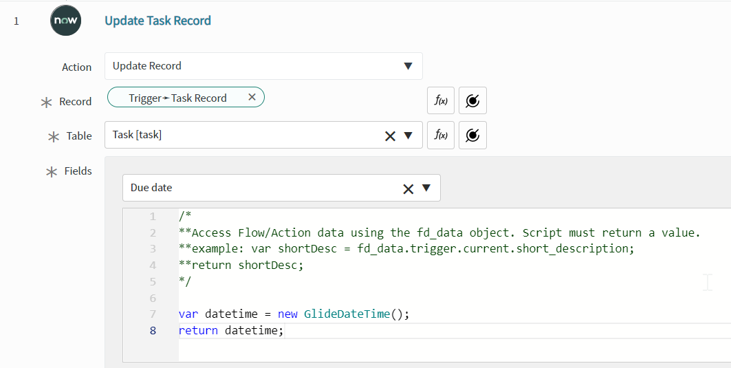

OK.  I know this should be real simple but not getting the code to work.
I am setting a date field using a script instead of a data pill in one of the steps in a flow using the following code:
var invite_dt = gs.nowDateTime();
return invite_dt;
The system keeps resetting the above code to just GlideDateTime.
I have spent an hour figuring this seemingly simple task out and now reaching out to the experts here.
Thanks in advance!
Mahesh

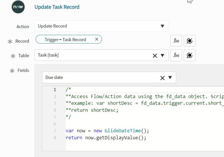

Kieran Anson
It should be new GlideDateTime(); as your function rather than using the glide system method.
var invite_dt = new GlideDateTime();
return invite_dt.getDisplayValue();

Mahesh_Krishnan
Anish:
When I tried your code I got an error stating that the code needs to return a value.
Kieran:
The GlideDateTime() class manipulates existing dates; it does not set the current system date.
I was not able to get the flow to even accept the code.  Not sure if I am doing something wrong here.
I realize the mistake I did. Thanks for notifying.
