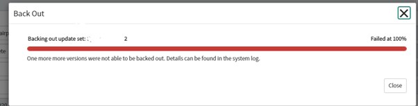

I am facing a strange issue while backing out an update set as shown in image
Initially we had 20 update sets which have child-parent hierarchy defined in a batch base. So i did try to back out batch base directly which caused some errors. Then i opened all 18 update sets and tried to back out individually , and i was able to back out many . But 2 update sets are showing this error continuously and are not getting backed out.
Also, the update sets include portal related changes (widgets , images etc. ). I checked in system logs as well but didn't help much .Please suggest how to back out so that I can re-migrate new update set with correct changes.

Since you have tried both now backing out parent batch as well as individuals, something might have gone wrong in terms of sequence etc. For now you can just recapture the parent batch again and move it to the same instance, then check if there anything missing so that you can capture it for your higher instance move.

When I create a new table and then back out of this update set, this issue occurs. Have you resolved it?

I recently encountered the same error message during a backout process. In my case, there were two update sets with the exact same name in the sys_update_set table. To resolve it, I had to back them out one after the other.
